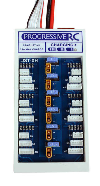

To charge multiple batteries you will need a Parallel Charge board, and don't cheap out, get one that is a "safer" charge board with fuses or Poli-fuses (they are like a circuit breaker that pops on heat and resets once cooled. It is hard to beat the JB charge boards for price and quality (cost more because they have Poli-fuses) but are limited to one cell count so you would need a few of them. There is no board that has all the connectors and cell counts you will ever need, so you won't be able to get 1 board that fits all the bills.
I would suggest weighing these as they are the best/best bang for the buck.
The perfect marriage of safety and convenience, our new safe parallel boards are ready to make charging hassles a thing of the past. The board comes fully fuse protected, with 15A blade fuses on the main circuit and self-resetting polyf
www.progressiverc.com
You may need to shop for another board later if you get into newer/rarer options in the future like XT30 and 6s

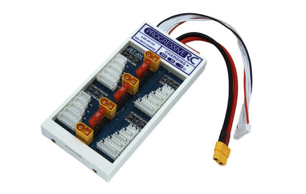

I use a 6 headed banana to xt30 cable and then use the balance lead on one of my parallel charge boards to connect all the balance connectors.View attachment 3396
could I see the balance lead you then use I just run mine down the parallel board then input each balance lead .. also very stuck for space ,, this looks cool
From what I could gather from your post, you are doing it the same way. Since there is no battery main leads connected to the XT60, the main banana leads have no voltage on them, so I just leave them unhooked. The XT30 goes to the charger, the parallel board balance lead goes to the charger, and here I have a 3s XT30 ready to charge. Questions?
