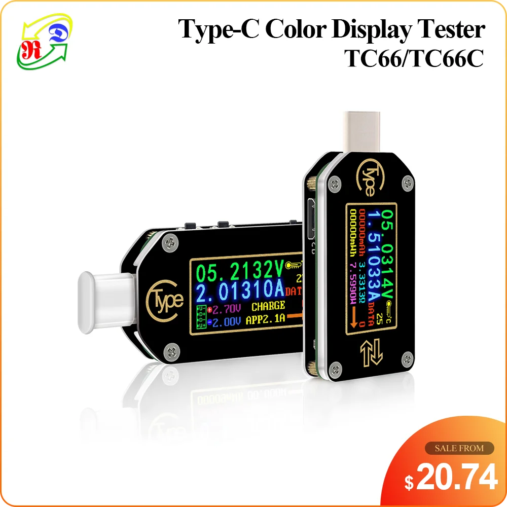

@Kilrah what brand/model is that USB-C tester? I have a few older A/micro/C testers that are really flaky with PD, really cable sensitive, won't negotiate and connect through them more often than not.
