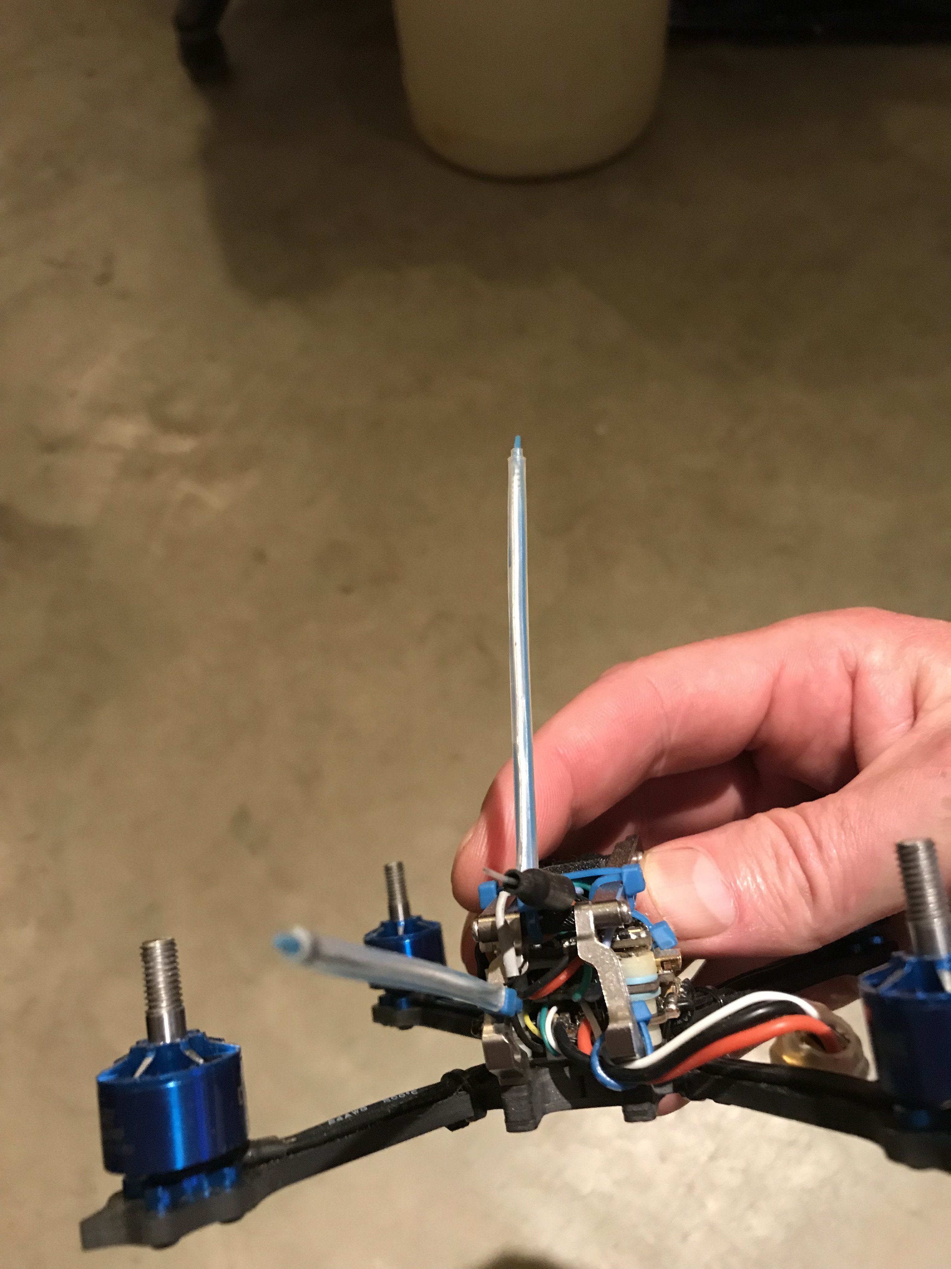

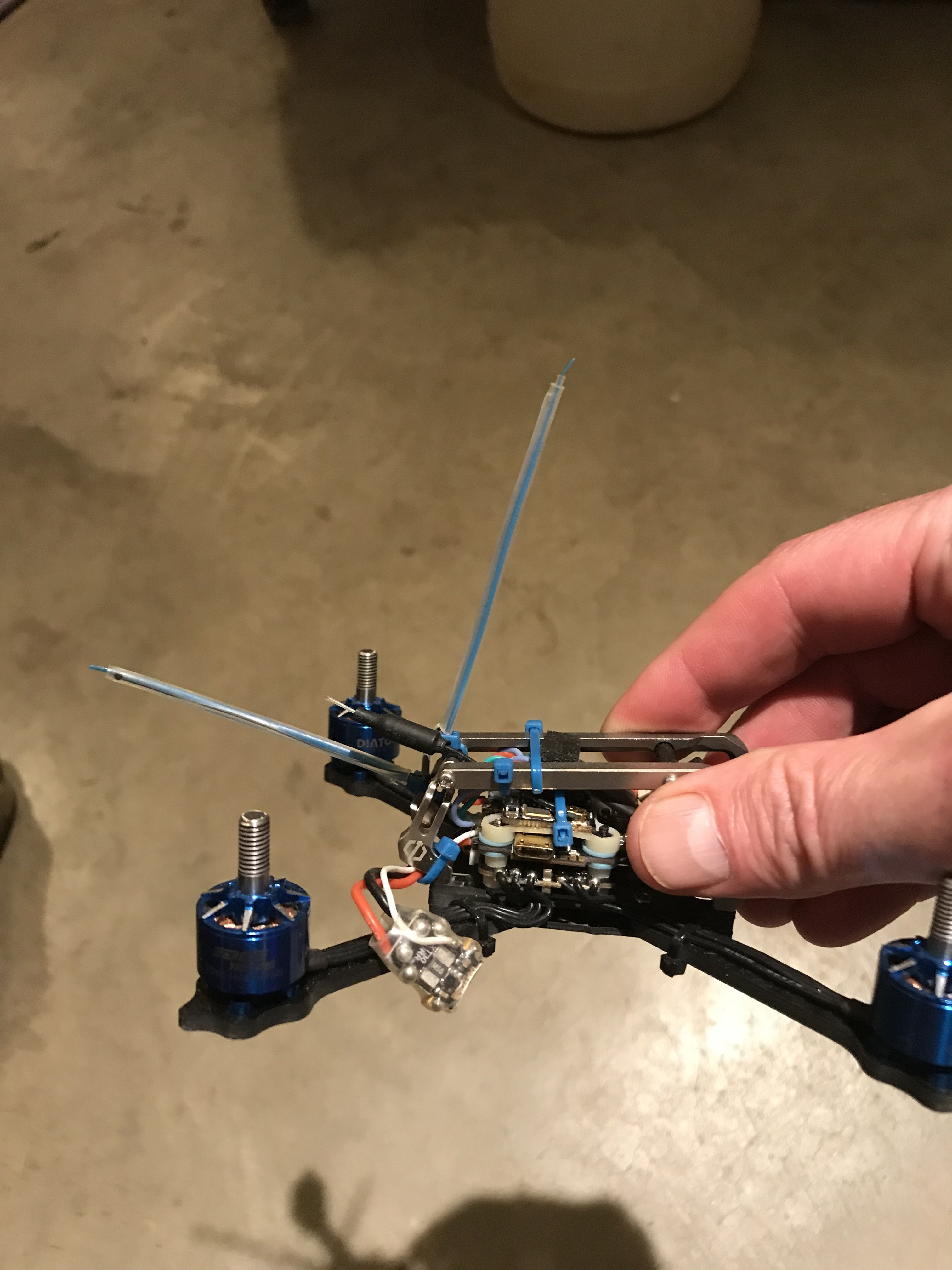

I don't think that's going to work. Where are you putting your battery? I would think you want a 2200mah, that won't fit up top with the GoPro mounted there. My 250B is balanced pretty **** good and flies great. Take a look at these pics.

Yes, I removed the stock mount and just put some long extensions between the top plate of the frame and the stock camera plate (homemade). Also, get rid of the stock antenna, you won't get any distance with it at all. I ran my antenna higher so I wouldn't get interference from the GoPro when the bird is facing towards me. Do the mod to the plate inside the bird that holds the flight controller. The way it is stock let's the FC move around too much causing a mushy response to RC inputs.

Sorry to say but the GoPro mount won't work. I would bet it'll get banged up on just a hard landing. The case is going to add quite a bit of weight as well. The angle has been an issue for me too. There aren't any good solutions available for this frame. I'm going to make a wedge for mine to mount to the camera base plate.
If you look closely at pic 1 that I sent. The frame should have two little clips and a small rubber grommet that holds the antenna to the frame. Another reason I have the antenna extension anfpd the longer antenna. If I do crash, it just bends over instead of breaking the connector on the VTX.
