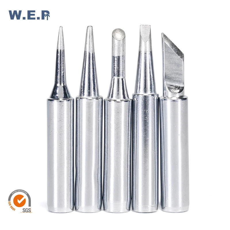

You will need at least a 80-100 watt iron to make a good joint onto the ESC, my 120W Weller station can sometimes struggle to get enough heat into the joint on the battery connectors on home builds. A imperfect (dry) joint is not what you want on a motor connection!
Soldering subject.
A soldering station is what you should be considering. Adjustable temps are a real plus, along with the changeable tips. This particular tool is no different than anything else in that you are better off buying too much than not enough. Think of it in terms of horsepower. You won’t make it up that steep grade pulling a big trailer without enough behind the gas pedal.
yeah, Ive watched the teardown videos - looks straightforward enough - and I have a soldering station, and fine tips.. so all of that side is not an issue.
I just wanted to hear from someone that has actually done it... first hand experience is always valuable.
