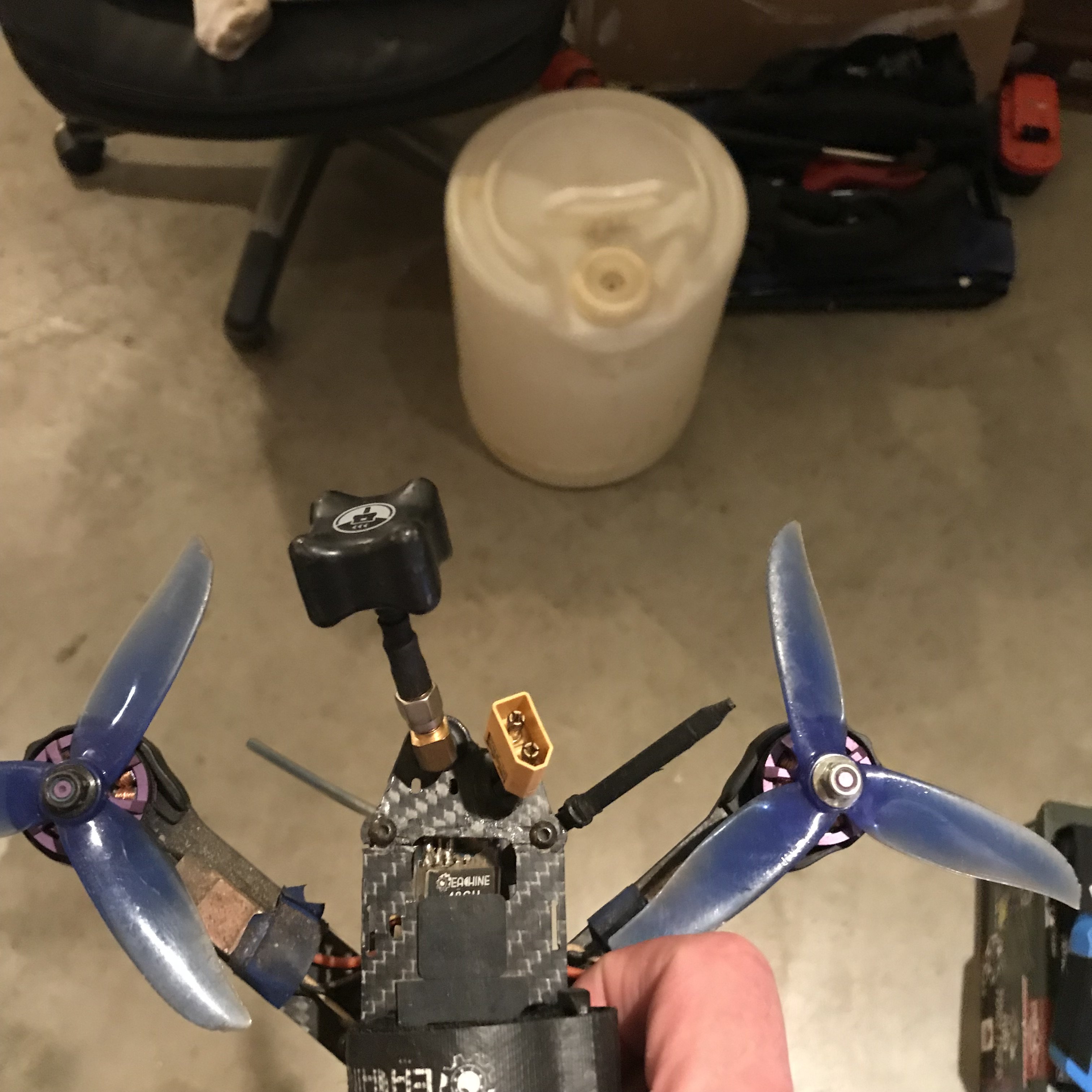

Hi Guys,
I have wizard X220S with Flysky FS-I6X remote. For better reception I have upgraded receiver to Flysky X6B. But still after aprox 200 meters I am losing signal. I found this video on how to Upgrade remote antenna: Flysky i6 antenna mod
Do you think is it worth it? or are there any other options?
That is your biggest problem then, the carbon completely blocks RF energy, mount your antennas different and test before you ever bust into the radio. Maybe try to mount them something like one of these arrangements. Up and away from the frame is your bets bet.
Great thanks, I will try something. 90 degree angle at least must be between them right?
