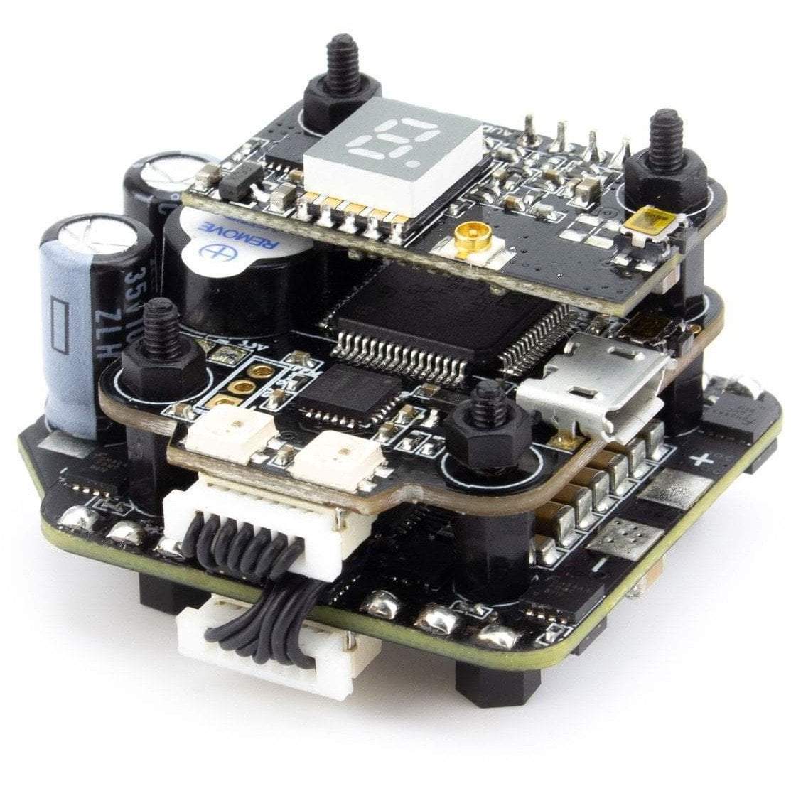

yeah I think so also. I would like to thank you for all your help. I found a new stack it's called iFlight SucceX Mini F4 V2 35A with VTX Flight Tower Stack. are they good? or what would you recommend
That is a relatively new stack in the market but gets good reviews, seems like a good choice, but you may want to also consider the Mamba stack, it is more cost effective, has a good track record, and 25 amps is more than enough. The SucceX is so much more because it is rated to 6s and 35 amps, not sure I would recommend 6s on a 140mm quad, but you could if you can afford the batteries for it.
