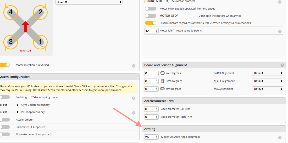

You can also check your gyro calibration and increase your Arm angle. If the quad doesn't think it's flat it won't arm
