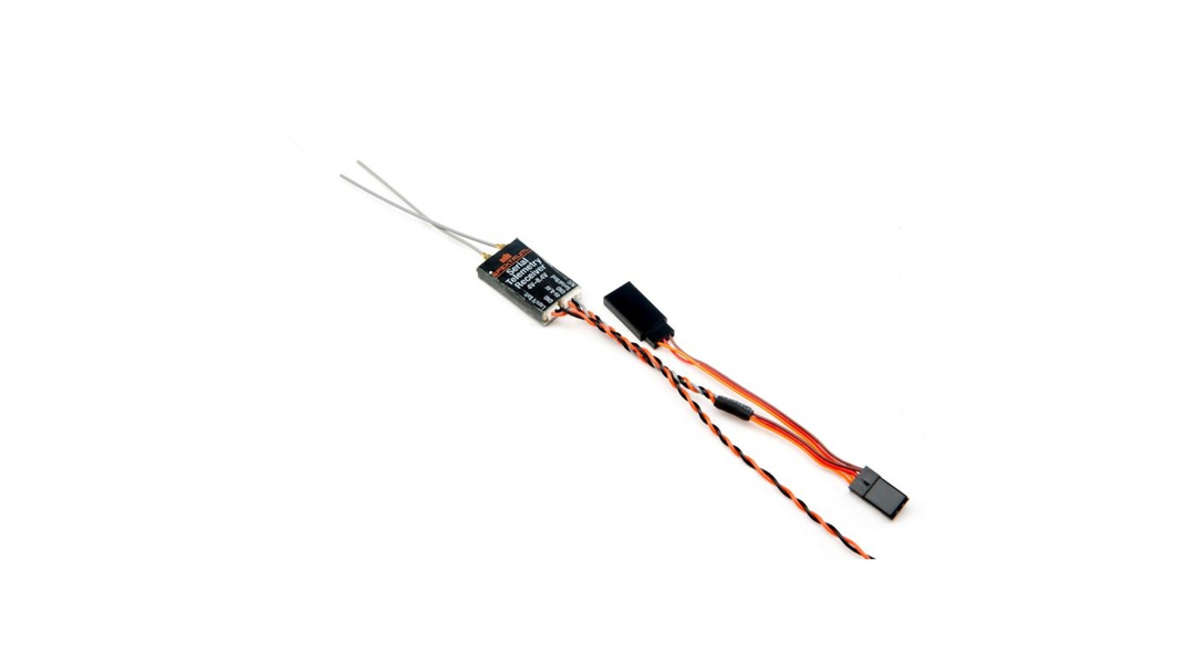

I think this is the new hot lick small rx out there, not sure if the Dx6 does DSMX or just DSM2 or whatever, wish I knew more about spektrum so I could advise more confidently.
Well I’ve been having a sniff around the web and I’ve found a thread on another forum suggesting that the DX6 will bind to both DSM2 and DSMX receivers but having absolutely no experience in using Spektrum, I don’t want to stick my neck out... Maybe look out for a second hand QX7 and any one of the myriad of frsky receivers?
