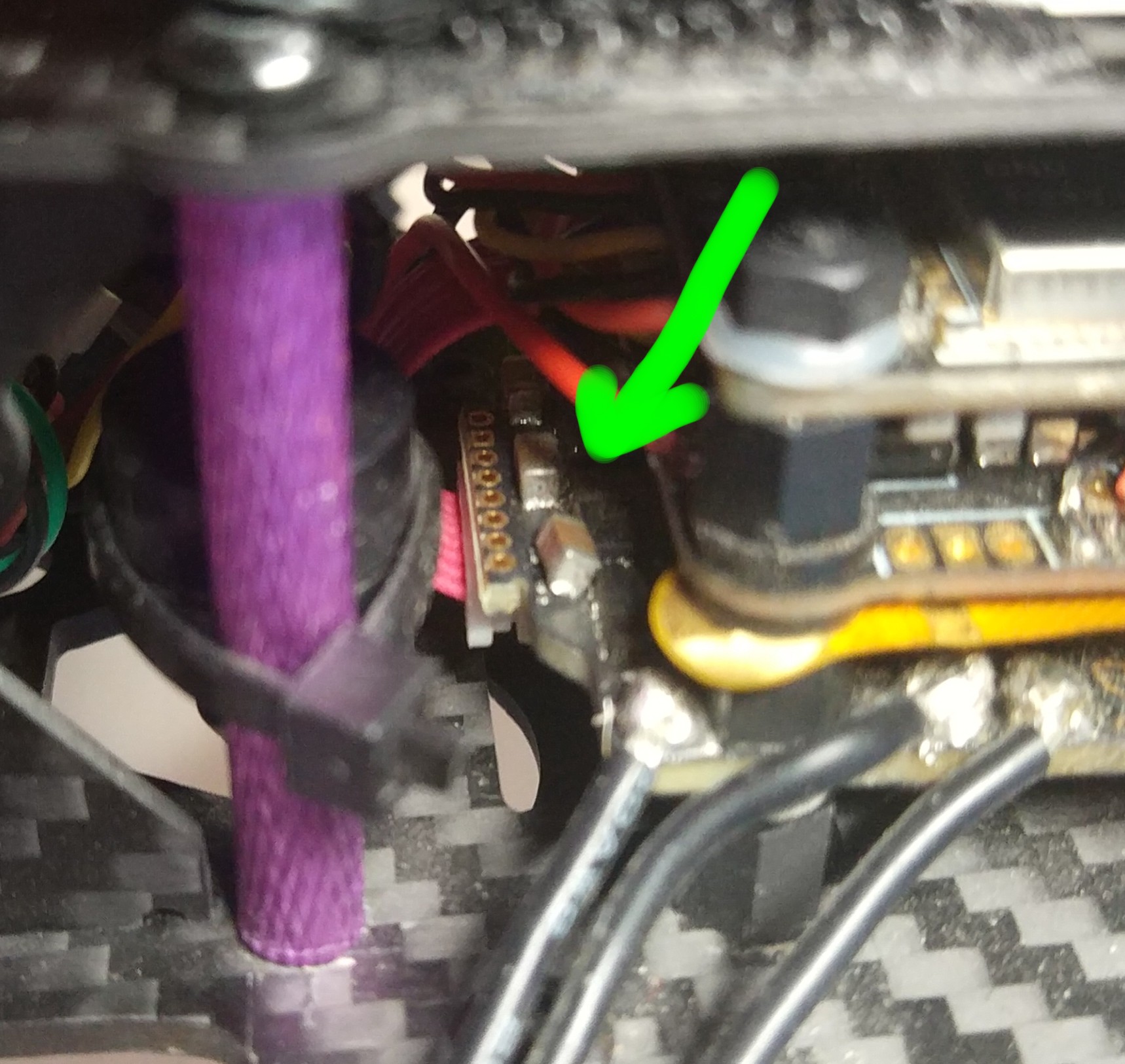

I also noticed a damaged component on the esc:

I tried different pid but the problem didn't go away so I am thinking that something is damaged, maybe that component on the esc? I don't know
I hope someone with more experience can help me. Thanks!
That small component on the ESC is just a capacitor, and is unlikely to cause your vibrations. You should look for bend propellers and/or motorshafts.
