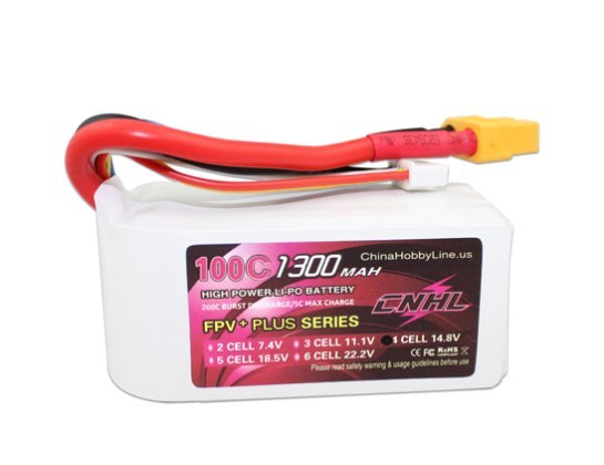

Hey everyone! I used to fly DJI drones and got very interested in fpv some months ago, I built my first 5" and I learned a ton but still don't know a lot about LiPo batteries. I've got 4x35A ESCs and wanna know if I'm looking for another 4s around 1500 - 1800mah what would the discharge rate be as I'm looking for the best response I can get from the motors, they came with a kit and they're 2205 2300kv but I'm thinking about upgrading. Thank you!
75c or better for a rule of thumb, and if you want better performance on motors that small, go with a slightly smaller battery to save weight.
How do I know how much current the escs can take? Would it be 140C max?
There is no max C rating because it's a rating of potential discharge. A higher C battery is able to charge or discharge faster without damaging it's self, so the only downside to a higher C rating is cost.
On a side note, C ratings on batteries are largely estimated or downright fake. If they're claiming over 140 they might be claiming their burst rating or something. It's gimmicky. 75 - 120 is probably realistic
