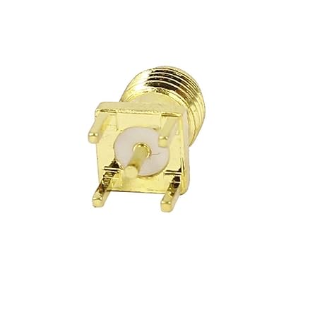

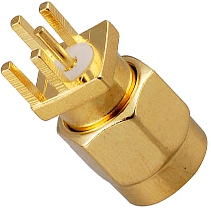

@DavidKersting, do not use that setup, the center pin in the sma is WAY too short. to re-use that board you will need to cut the legs on the old one to remove it, then remove the leftover soldered pieces with the iron (since they are all separate now after cutting off olds sma end) and solder on a new one. If the pin is too short on the board side you can just use a small bit of wire to solder to each side or just bridge it with solder. Then just makes sure no short between the 4 ground leges and the center pin and off you go. You want ones like this
NOT THIS!
