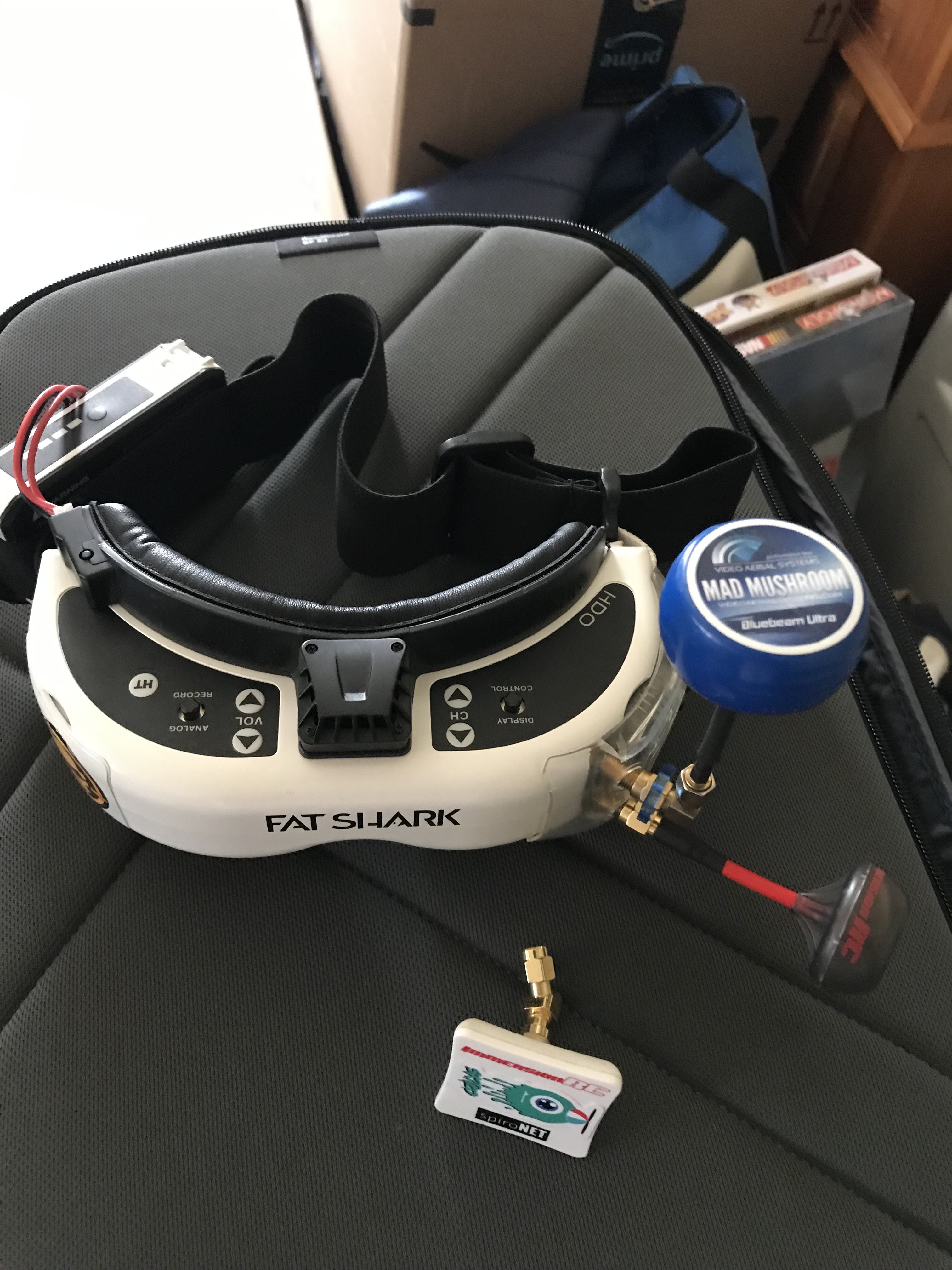

While a good set of antennas is the best upgrade you can get for the goggles or quad, most antennas are at least ok and should work fairly well for you. On the quad side, it is very important to look for something very durable, I have tested a number of antennas and find that the TBS Triumph Version 1 is the best I have found for both signal and durability. I have tried AXii, Foxeer Lollipops, and a half dozen other "top rated" antennas, some work pretty good, but they just can't compare to the original Triumph. They are getting harder to find now that the Version 2 antennas are out, and those have very good signal but just aren't as durable, so the cost of replacement can get high over time.
The antennas on your goggles wont be flying into trees at high speed so they will last a long time, it pays to get good ones for your goggles. On the less expensive end there is the ImmersionRC Spironet V2 series or an Aomway cloverleaf, they both work very well and won't break the bank. For a diversity receiver on the goggles I like to use 2 Omni directional antennas at 90 degree angles to each other for all around flying, if I want to go straight out really far or try to get deeper into the woods or around large buildings I will swap one of the Omni for a directional patch.
If you want to get something really good I would suggest the VAS Bluebeam Ultra/Mad Mushroom set and maybe a Crosshair XTREME for the patch.
Some links from GetFPV below but you can find them elsewhere too so look for sales and discount codes/coupons, but for the most part they cost the same anywhere you look.
Make sure you stick with either RHCP or LHCP, they need to match and 95% of the pilots all use RHCP. Also make sure you know if you need SMA or RP-SMA, if the pin is in the antenna it is SMA, if the pin is on the quad it is RP-SMA, order accordingly. Also keep in mind how your connectors come off your goggles, if horizontal you will want a 90 degree FOR ONE OF THEM if you get 2 Omni's so that one of them points straight up, if it comes straight out the top you will want a straight antenna connector. Or you can always bend the coax portion in a gentle bend to align them. I am only putting the SMA/RHCP links below as an example but some will have a 90 degree and some will be straight, sometimes you can get the antenna with the 90 built in, sometimes you need to get a seperate 90 or 45 degree adapter, usually one straight and one 90 will always work for Omnis since you want them at 90 degrees to each other.
For the quad side, but yo can always use one of these on both quad and goggles.
For the goggles side...
This is what I am running for the last 2 years, the original Mad Mushroom and a Spironet Omni or patch depending on what I need at a fly spot.
