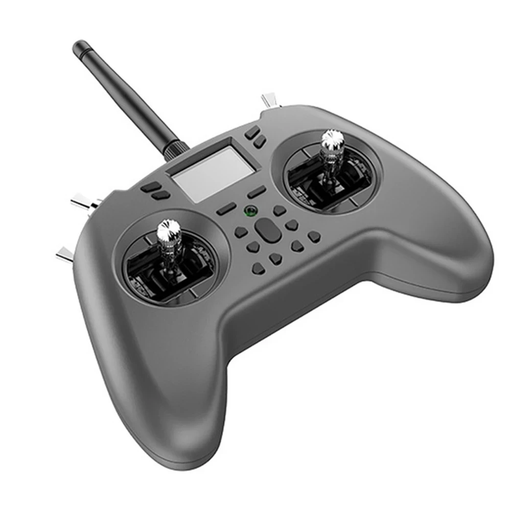

I'm thinking into buying this transmitter
will it work with this quad? I'm in doubt because I don't know if this quad comes with a receiver or not. Also, is this controller that I chose modular? In a way that I can swap for other transmitter modules?

It means there is a video transmitter but no RC receiver.

Thanks. In fact I want to buy one transmitter for usage with all my quads in the future, but that also works in this one.
