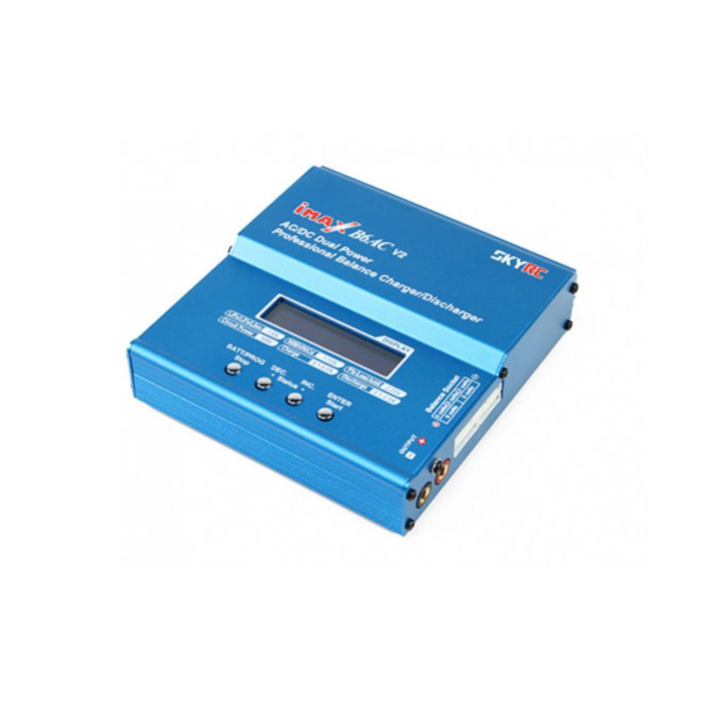

Still no charger though. Is there any charger that will work for both the drone batteries and the radio battery that you could recommend?
I’ve got one of these that’ll do the job for you:
You will need the balancing charging board to go with it to be able to charge both Lipo and NiMh types. Not at the same time obviously.

I found these on Amazon in Europe, where I am based:
Do these seem correct to you?
Also do the board and the charger come with all the required cables? I'm slowly starting to realize this is still DIY rather than out-of-the-box territory so I want to make sure I buy everything I need.

Oops, and I just realized the QX7 battery I had bought is also a LiPo, as in here:
Does it need to be NiMH specifically? Is this one not going to work?

That gear will work fine and should have all you need to charge XT60 out of the box, but you will need a banana plug to XT30 for the goggle battery.
That goggle battery will work fine, but I would suggest only charging it to 4.2 since charging an HV to 4.35 will likely reduce its lifespan, and keep in mind it is a LiPo so you may not want to leave it fully charged for long. If you charge it to 4.2 just before you go fly for the day and get it down to 4.0 or slightly less, it should work fine and last a long time.

By banana plug, do you mean this little fella?
Thanks so much!
Nah, one similar to this. One end plugs into your charger and the xt30 end into your goggle battery.
@bzmot, what I meant was you posted a link for XT30 connectors and asked me "By banana plug, do you mean this little fella?" and I was saying no those are not banana plugs and that they were XT30's. I then said you needed what Tevek had posted a link to, which is a Banana plug to XT30 adapter.
So you do not want these, they are bare XT30 connectors, and they are NOT banana plugs.
This is what you need and it is a banana plug to XT30 adapter cable. the banana plugs should fit in your B6 charger, and the other end goes on the battery.
DO NOT FORGET to attach both the main leads AND the balance lead, and only charge in Balance Charge mode.
Yep, the battery xt30 connector is male and the banana lead xt30 is female. As @HighTechPauper has pointed out, keep an eye on your charging voltage.
