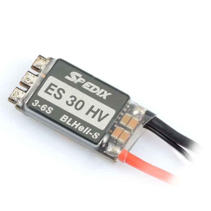

Those are good looking esc HTP!
It weighs a couple grams more but I'm tempted to put a newbeedrone infinity FC200 in it. large overkill but.. Using this in my new 5"
Other than a bit more $ more.. this stack should be beefy. Any draw back going this way?
I like the esc to FC plugs so should have said I was looking for a stack.
The spedix above looks right but the matching FC is sold out.
I might get the spedix too and see if zi can make it work with the HGLRC F420 FC. This is my second blown HGLRC 4in1 so.. we now know it won't stand up to Nates crash record. The red was nice.
