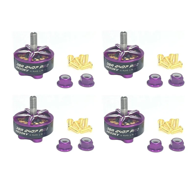

Once you hit 7 inches you want a bigger motor than a 22XX. I would be using a 2408 or even a 25XX series motor to swing 7 inch blades.
rtkDarling, motors out of stock! :) Must buy other.
Pleass give me good motors :)
Do I looking 1700kv or smoller?
If yes, I found this 24xx:
1500kv
1700kv
2508 1200kv (from rotorbuilds page you gived me).
Tell me what you think of this.
The BrotherHobby 2507 1500 kv are great for a 7" build, I have them on my iFlight XL7015.JPG

Will be fit on Martian II frame?
There are dimensions of 22xx and 25xx motors, the same is 16mm in middle i see.

I was looking at that. I couldn't find the screw pattern info for the frame
If 22xx and 25xx motors have same hole distant, and in manual of frame 22xx are recomended, so it must fit 25xx, I think.?
If not I can print a new one or only some extensions for bolts.
Look! He build 2205 on martian II frame!! :)
(But my frame will be 295).
Yeah, he's running 5" compared to your 7", it does make quite a difference
Take a look at this, he had the same problem, and he outlines some of the problems with seven inch.
He's running a 2806, it's a monster. Also remember that he's running his on 6s compared to your 4s, that's why his KV is so low.
