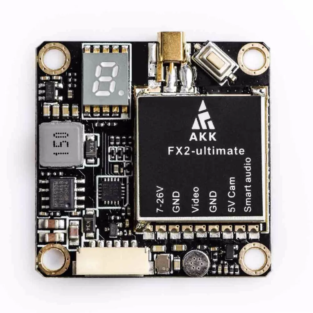

Hi. I was set 'in goggles' power on 200mW ( I save it), but it seems I got same FPV distance like at 25. Then I search and find this (at 1:20min)
He explain that not exactly mW same what you set in goggles and one in vtx on quad, like if you set in googles 200, will be only 25 in vtx, etc..
Is that right or not true?
I am ASSUMING you are using Smart Audio or Tramp and that you KNOW it is working correctly. Yes it is possible that the BetaFlight OSD and vTX power are misleading if you don't understand how it works and what it means. BF is not smart and it does not know what the lowest and the highest power is for any vTX, so it just says to vTX, set to power 0, 1, 2, 3, 4. It has no idea what power level is associated with those numbers. It also does not know if the smart audio or tramp is actually working or not, so the display may say one thing but the vTX is not really set to that. The best way to know is to look at and decode the LED's on the vTX to make sure.

After one crash I loosing fpv picture on short distances.
On 25mW around 150m the picture are very bad (before I was go around 500m without problem).
Yes, I turned ON diversity in googles.
I opened quad and don't see any broken wire.
I know that exist thousands things for that problem, but it looks to me that something can be from VTX or Antenas? Dead resistor?
Can blackbox help?
No, Blackbox will not help, it is for FC and motor issues, not video issues. It is likely vTX damage or possibly antenna issue. You will probably need to replace them if you cannot find damage. Look close at antenna center conductor is still attached to vTX, otherwise replace may be the only fix.
