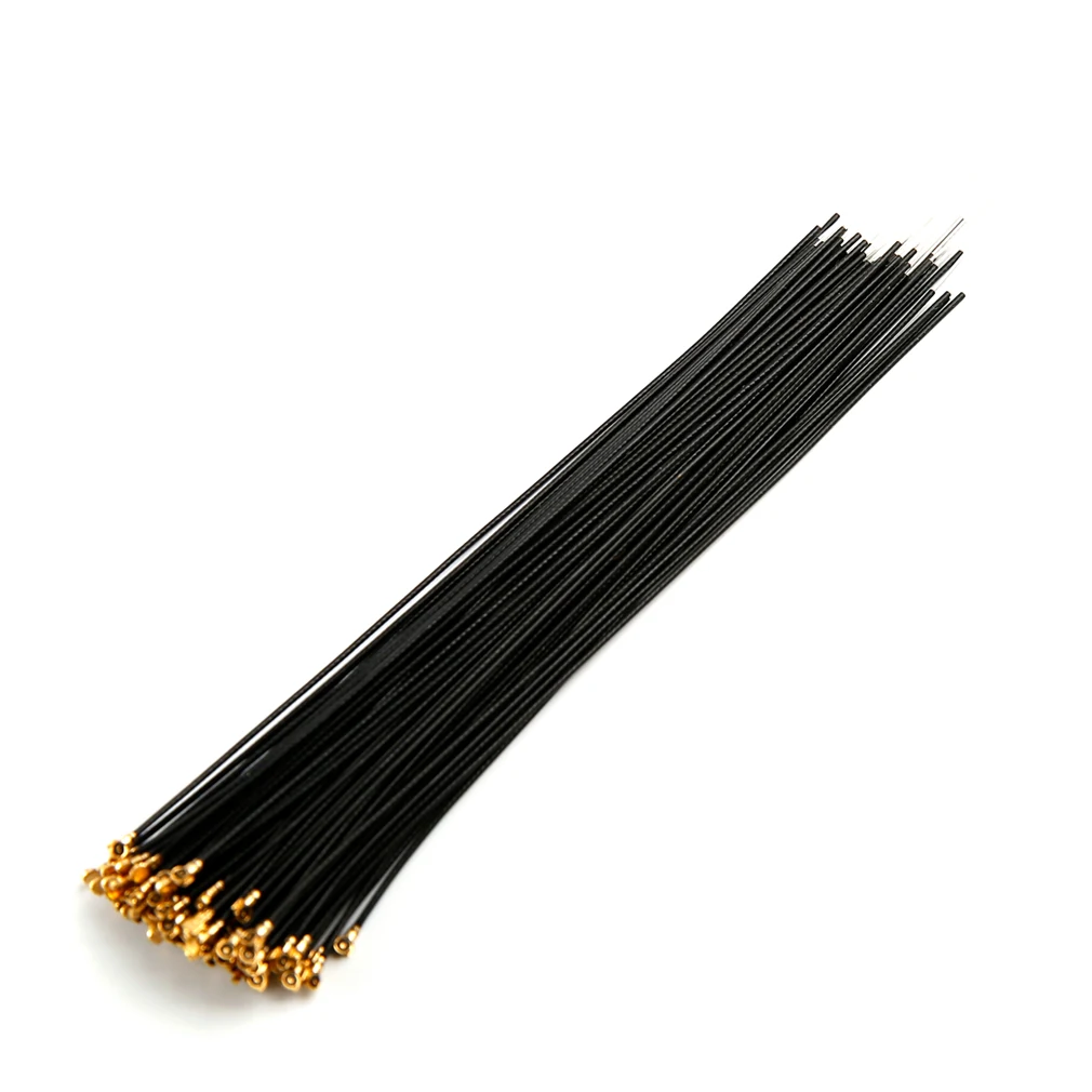

In crash was cutted a some milimeters of left antena. I know how to repair, but also
I want buy a new set.
I see some antenas not same thickness like original, is that important?
Thickness antena is less!!!(see feedback)
Or "realy original?"

Ok. You not see feedback replay with picture. I will add it here.
Look original reviever and replaceable antenas difference:
Yes, thank you for PM.
Ok, I do see the difference in diameter in this picture, it could be that they are not the exact same coax cable and the original is better, but they should be almost the same performance as long as the silver end is the correct length. The total length is different also but it won't matter as long as the silver part is correct length.
