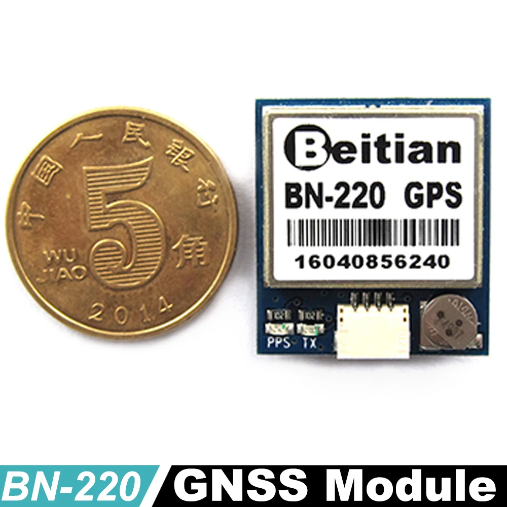

I waiting new gps. I wonder what is cause that??? I hope that will no happen again.
