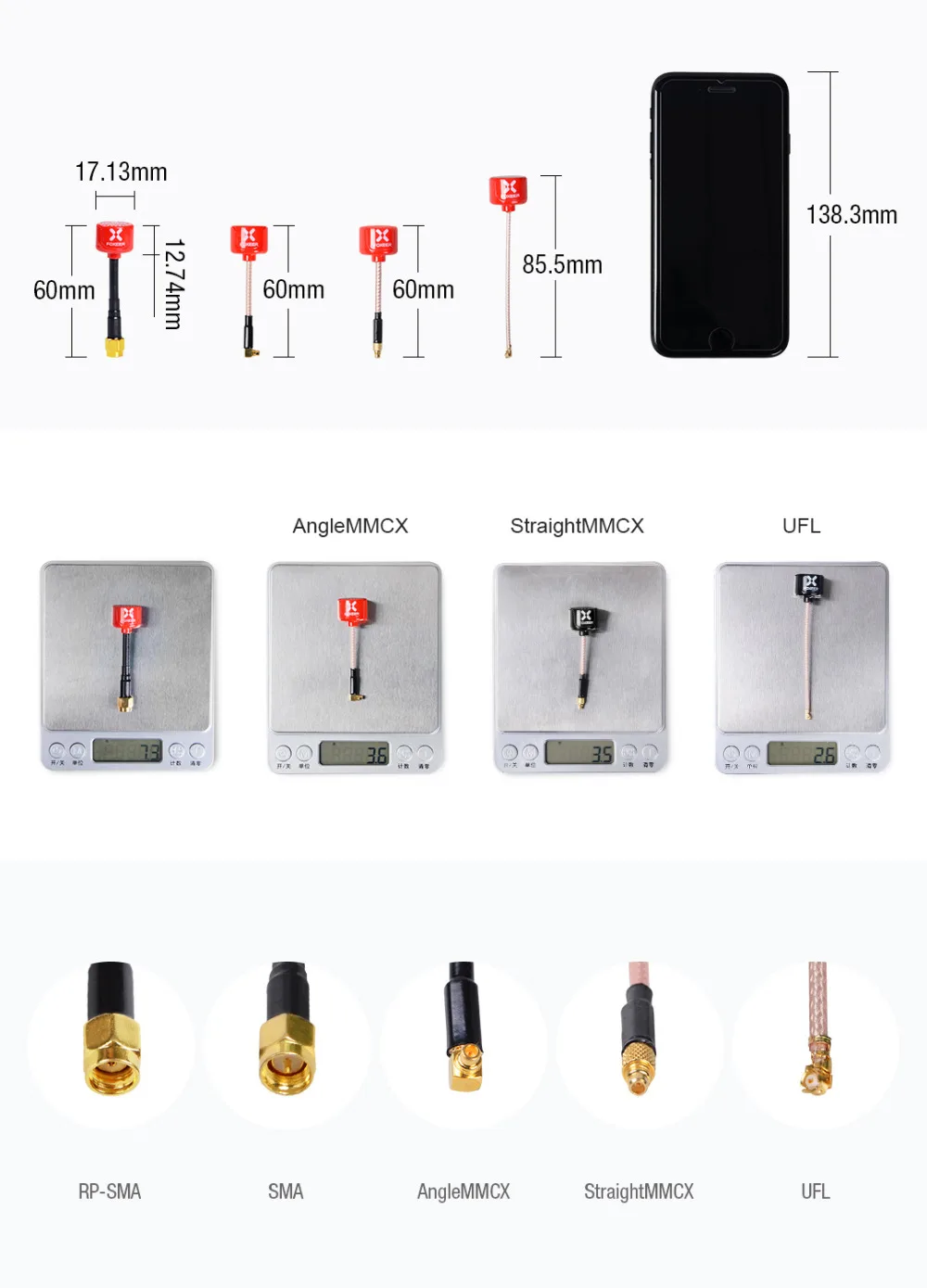

Sorry, but what you got is RP-SMA, that's the female version of SMA
You can return them, or get a SMA converter. They're pretty cheap little parts, but they do add some weight and take a tiny bit of efficiency
If you sure that I have rp-sma, then he sent me wrong :eek: I ordered SMA.
Is my order was good? See
Item Link here.
I will go for new item.
And got Lolipop 3, but ordered 2.
Looks right to me, RHCP (Right hand circular polarized) SMA. You can see the image I linked to is from the ALI express page you ordered from; looks like they did send you the wrong one.
[EDIT] version two or three doesn't matter much, giving you the latest iteration is probably a good thing
If you open a ticket and state they sent you RP-SMA instead of SMA they should honor it
It is ok using this extension, because loosing of signal?
That is only way to use antena in my way now..
Or
I can buy 1 antena separate SMA(goggles), and other with angle MMCX for direct to VTX connect.
Other sellers have that options for buy..
(maybe 2 for goggles).
You can use the cable without any significant loss, but the experience I have with the Foxeer Lollipop is not very good, you may want to super glue the seam since every one I have ever had falls apart pretty easy. When mine fell apart I still had the piece so I just glued it, but many times it comes off from clipping a tree and then it is gone. I really don't use them but I have gotten a few in subscription boxes and use them to troubleshoot vTX issues sometimes, I prefer an sma pigtail and a rev 1 TBS Triumph, the rev 2 Triumphs fall apart just like the Lollipops.
That's good to know. I've only had 2 of them, and both ended up too close to the carbon to take a real hit (just because of how they are oriented) Now that I push all my antennas out further, I'm going to need the tougher ones.
And to be fair, I think they perform reasonably well, they just aren't sturdy enough. I think super gluing the seam may help, and I just am not sure what I will move to once all my rev 1 Triumphs are gone, but as sturdy as they are that should be a while.
